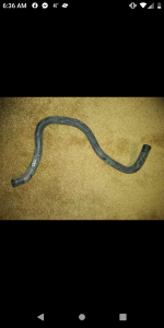

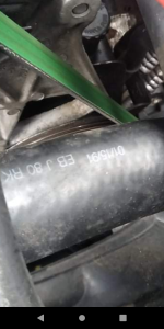

I was trying to find the factory ones with factory date codes and stamps. I'm still struggling with photo up loads. See if one works? This is the S shaped one I believe DaveP is confusing himself with another. I have 2 of the heater core hard-line to radiator which Dave had scratched the surface with.
The trials and tribunals of truck ownership.

wildphil
I Love My Ty's
The hoses that I have will not have the correct date codes in them. Those are going to be very hard for you to find.
