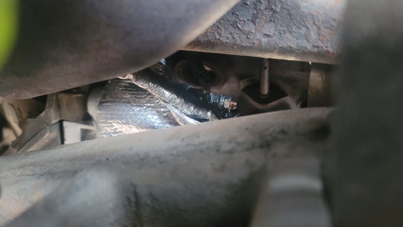

Some tips for people in the future replacing the starter:
  • The starter is on the passenger side behind the wheel at the front of the transmission in case you don't know exactly where it is.
  • Tools I used:
    • 14mm and 15mm sockets for the mounting bolts and the nut that connects the big wire. Note: my old starter had a 14mm nut for the big wire. The new one has a 15mm nut. Have both handy just in case.
    • 8mm socket for the small wire
    • 3 inch socket extension
    • Air ratchet (electric will work too): While this is not absolutely necessary, it does makes things much easier to remove and install the nuts attaching the wires to the starter. There is very little room for turning a wrench or ratchet.
    • Jack, jack stands and wheel chocks: standard equipment for jacking up your truck and working under it safely.
  • Consumables used:
    • Silicone grease: Applied to the electrical connections to prevent corrosion
    • Blue thread lock: Optional. Applied to the two mounting bolts

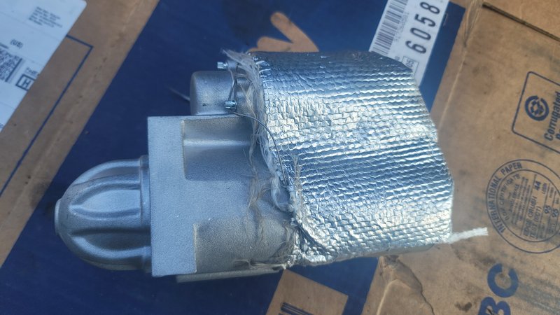

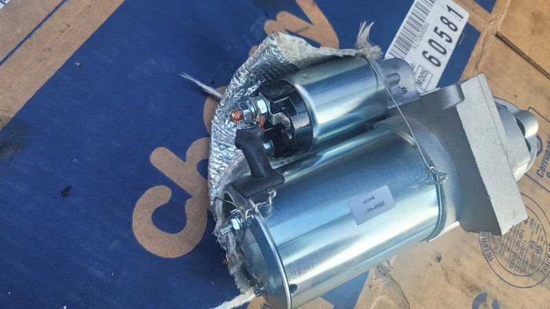

    • 6 x 10 inch heat blanket + lock wire: Optional. I hope this will extend the life of the starter since it appears that heat is radiated directly to the starter from the exhaust.
I only covered the outer edge of the starter with the heat blanket. I did not want to completely encase the starter in it because of past experience. I have wrapped the exhaust in previous cars in exhaust wrap or blankets and it resulted in them rapidly rusting. I believe it is cause by water condensing under the wrap/blanket and not drying out. With half the starter not covered, I hope to avoid any rust problems.
I tried to get the lock wire on tighter but that resulted in tearing of the thermal blanket. I settled on this. It is not up to aircraft standards but it works.

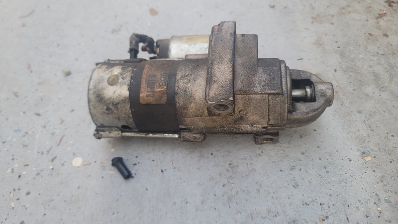

Here is the old bad starter
SacDoug
Did you test the solenoid before replacing the starter?
Yes. With the starter off the truck, I hooked up jumper cables from the battery to the starter, then used a screwdriver to bridge the two big posts. Nothing happened except a spark when the screwdriver touched.
