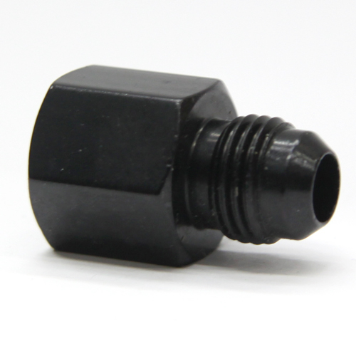

Anyone know the fittings by the transfer case to run braided lines up front?
I have a billet rail with braided lines to go from the engine to the transfer case.
I need the fittings for
Return line -6an to the return line fitting by the transfercase
Feed line -8an to the feed line fitting by the transfercase.

Here are the fittings. I think. There is a -6 - 16mm listed on the site but If I remember correctly the -8 an- 16mm and the -6 an - 14mm are the ones you are looking for. But not sure.
http://www.sytyperformance.com/inde...facturer_id=0&option=com_virtuemart&Itemid=26
14mm and 16mm are the fittings to the stock fuel rail, so you are saying the fittings by the transfercase are the same as by the rail?

I ordered the fitting from RPM.. Its nothing more than an off the shelf fitting that they machine down.. Then they provide a copper washer thats supposed to seal things up.. I'm not 100% sure its working.. My car has a fuel odor when I park it in our garage and I suspect its coming from this fitting.. Some time I'm going to take it to Renz's, remove the copper washer then just TIG the two together..
EDIT: To be clear the blue fitting and the copper washer is what RPM provides..

I have searched and found a lot but not what I am looking for.
I have billet rails and braided lines, I want to connect from the transfercase going forward with braided lines.

Since my Schrader valve is leaking and I already have some billet rails that I am just going to do the billet rails for now, connect to the stock lines by the stock rails.
I will do the lines to the tank later.
I have Mccoy railed and a Mallory regulator.
Plan to use this
-6 X 14mm X 1.5 Female, “O” Ring Seal
-8 X 16mm X 1.5 Female, “O” Ring Seal
