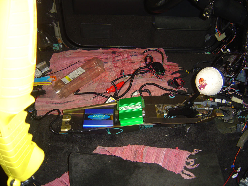

Here is what I'm working with

Re: Help: installing Ty center console in non Ty
Cool - I see your problem! I'll see what I can do.
Yes that helps. Thanks I'll see what I can come up with
Pictures of mounting points of the brackets that goto the floor and where the shifter cable goes
The rear of the console is 1.5" behind a line between those two plastic circles with the X in the middle - are they the mounting points for the seats?
The console mounts to these points - are these indentations in your truck?
I connected a cable between the two furthest forward screws on the trim to get a parallel line across the truck.
It ran in front of the centre console by about 1/4" max.
Does that help?
