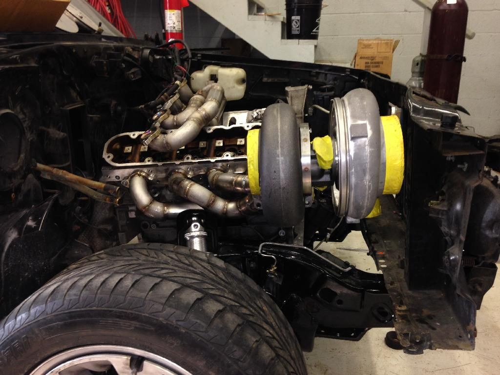

I have been on the forum for a long time and have owned a fairly stock sy for a while. I have been fairly involved in the LS scene for a long time, and was presented with an opportunity to purchase a syclone with an ls swap this summer. Its a 47k mile body, but the work done was pretty bad. I was planning on doing a single turbo setup when I purchased it, but didn't realize just how bad the origional conversion was done so it will take more work than previously expected. Plans are for a 4L80E (being built now), iron LS motor (370-402 cubes), and a single 94 mm GT5594 turbo from Forced Inductions.

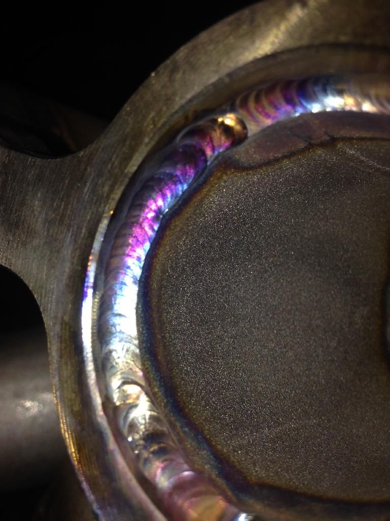

I have started fabbing stainless headers for the first time from sch10 stainless weld els. I have completed the drivers side and working on the pass side currently. I started with a Miller Econotig and picked up a Dynasty 200dx (world of difference, fyi). I am fortunate to have friends who have given me advice along the way, and figured that since I have searched the net before looking for advice on projects, it's not a bad idea to share what I have learned so far. I own a couple LS based cars, and this project isn't on a "rush" status, so I will update when I can regarding new progress on the build.
To start, here is my drivers side header not quite 100% finished but I will grab pics next time I am in the shop of the finished product:

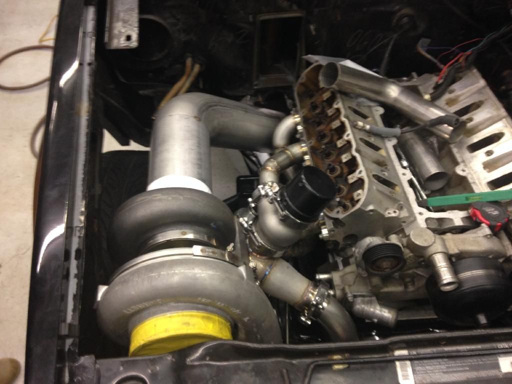

No issues with firewall. However, the turbo isn't a small one so it is very close to pass headlight and I have yet to determine what I will do for a inner fenderwell if I even have one. I purchased engine mounts from RPM and for mock up so far so good. I did purchase a crossmember for a 4L80E trans from them that is going to require modification although I need to point out that this is in no means their fault as the tolerences in these trucks plus the differences in swaps make it difficult to make a "universal" crossmember.
I am keeping it AWD and hope that the TC will live through the abuse but no idea how much it can take.
I am by no means a welder by trade but have friends that have given advice and I have spent a decent amount of time practicing. Here is my merge to the turbo:
Uploaded with ImageShack.us
If you have any questions feel free to ask.

I have more pics, but frame has been painted. Purchased sportmachines front A Arms and coil over. Hope to have cab on by this weekend. Used POR 15 after stripping the frame from surface rust and such. I am fortunate to have a great painter and friends to help on this stuff. Once it is donw, it will be back at my shop so I can finish the tubo hotside and start on an intercooler. Going to run air to air with methanol injection.
