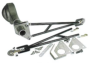

CKEITH said:
i agree w/ mike. let's talk about the goods and the bads.. make the bads good and duplicate them. i would imagine the community could possible benefit if these were available.
Bads
arms too short
front mounting point of the arms
doesnt have 360 degrees around the axle
MikeRenz
not stock
Re: My new Rear Coilover kit
warmpancakes said:
Bads
arms too short
sounds fixable.
Are these brackets to be welded to the axle? Does the non-360 degree really matter? If the brackets were complete circles, would we be able to slide them onto the sy axles? If so i could definitely make the brackets complete circles.
MikeRenz said:
sounds fixable.
the brake flanges @ the end of the axles won't allow them to just slide on. but they could be made in 2 pieces and welded together once installed. the flange or axle tube will break before a good weld will.
warmpancakes
MikeRenz said:
sounds fixable.
just order a kit from comp engineering or s@w race cars alot cheaper and better quality you will need to cut the axle flanges off, but there is no point in doing all this on the 7.5 rear diff if you are making enough power that the rear susp doesnt "work" anymore you need a 8.5 rear diff
MikeRenz
not stock
Comp Engineering Kit (from jegs anyway)
$206 ladder bar setup
$911 kit
so this kit is a weld-on complete 360...so i can easily make the back piece to the bracket. So that solves 1 'bad' :lol: As for ladder length...thats another story.
Anyone have pics of this kit installed?

Heres a couple pics marty sent of what it all looks like together .The syborg doesnt look magazine ready in those pics :lol:.. I am kinda glad my set didnt come with that panhard bar :barf:

I am looking at something like these .
Suicidedoors dot com
Air Ride Technologies
I would prefer a panhard kit that has poly bushings instead of the rod ends like this edelbrock one .
warmpancakes
MRKING said:
I
look at s@w race cars they have one and they will be 1/2 the price and twice the quality
