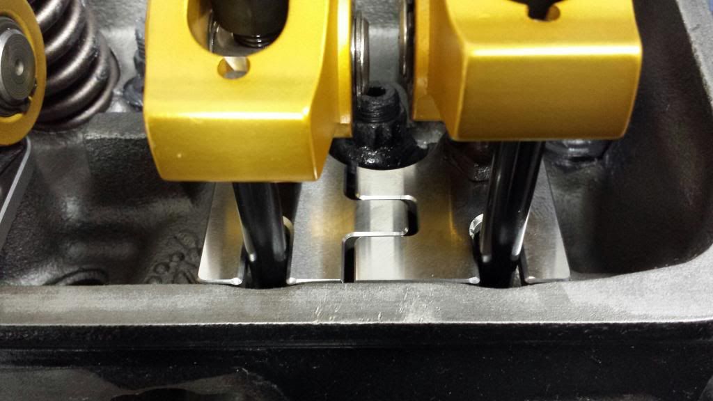

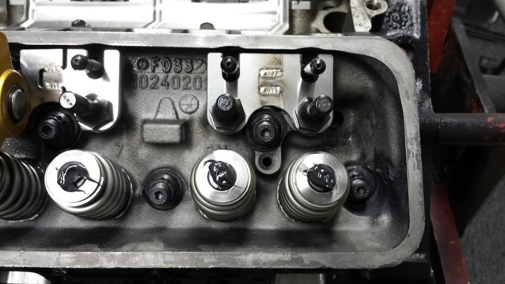

Made my own adjustable push rod guide plates. Made of 48-52rc S-7 tool steel, wire EDM'd out and cnc chamfered .187 thick. No sharp edges to cut the push rods.

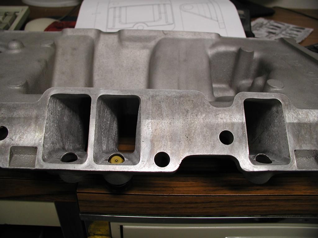

Finished porting my lower intake.

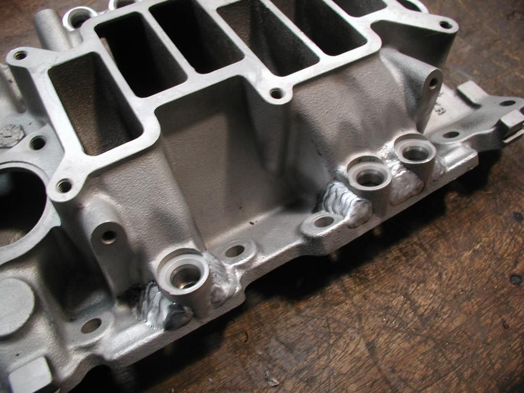

First I welded around the injector bungs.
Then blended the welds.
Next was CNC the ports and machine all sealing surfaces flat.
Here is pic with an injector in before and after machining.
Before
After

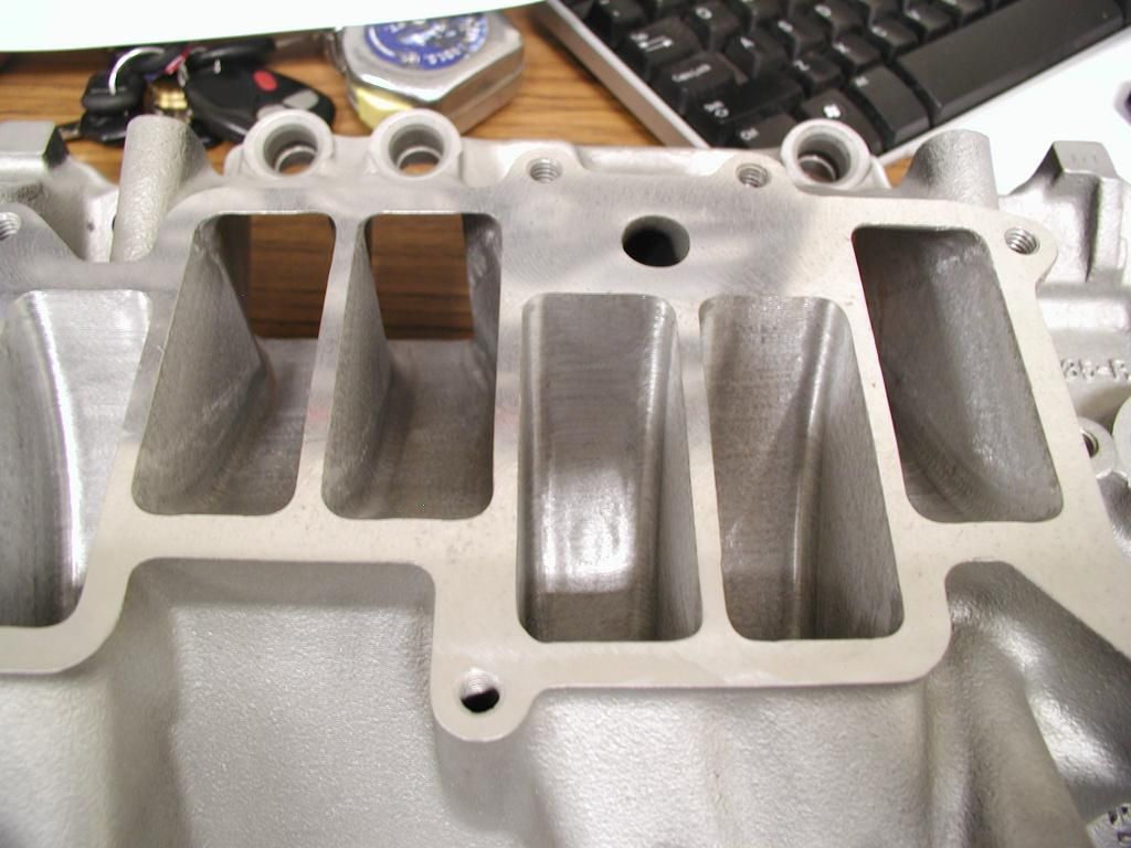

Also welded the EGR port closed.
Then a lot of hand porting and this is the final product.
With injector in

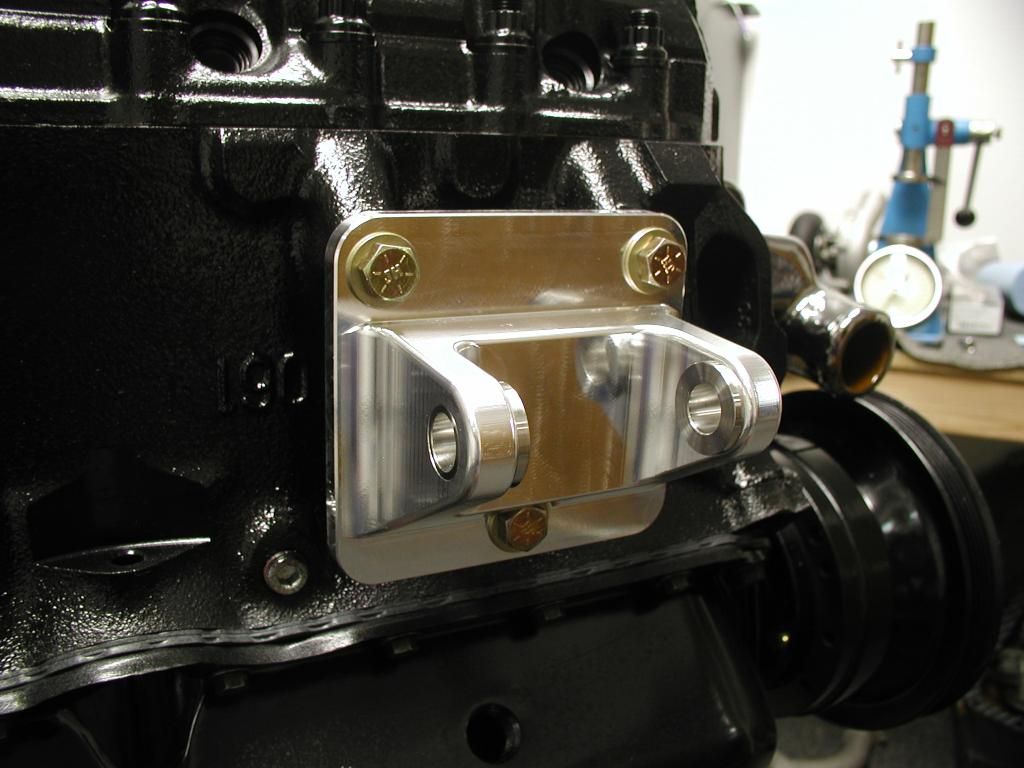

Finished my solid motor mounts.
Billet 6061 Aluminum with Nitronic 60 SS inserts.
4130 solid steel frame pads.
Assembled on the motor.
