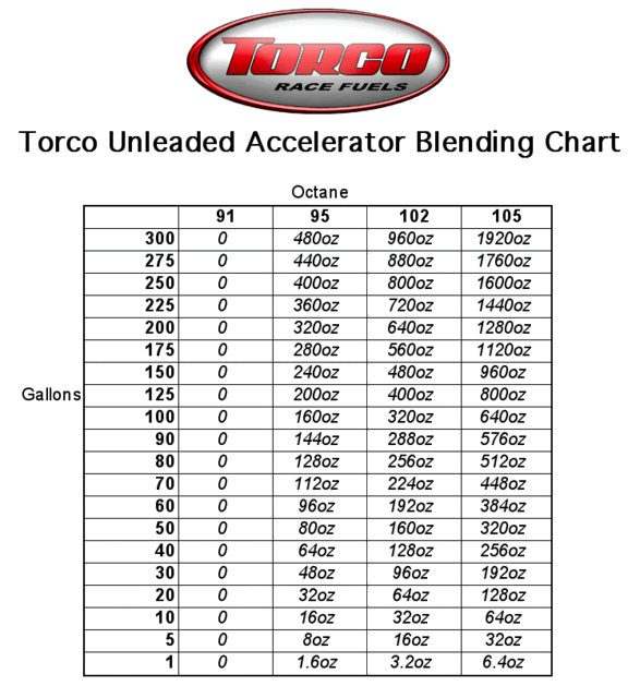

I am trying to tune out some knock & I am currently spraying 100% methanol w/an Alkycontrol system.
I am trying to run about 26 PSi of boost pressure & 91 octane fuel. So far, I seem to have some sort of knocking, even w/setting the timing tables down to 9*/degrees. (maybe too low of timing?)
I am not sure this is possible as not to have any knock while running 91 octane so I am contemplating of trying out some Torco Accelrerator.
I have always heard of this Torco accerator is great stuff.
http://torcoracefuel.net/2-docs/accelerator-blend-chart.gif
I would like to hear from you guys that has had knock issues & say how much knock you had before & after using some Torco & what octane did you increase it to?
Also, if any of you guys have tried Xylene & used Torco & if you notice if one worked better than the other.
