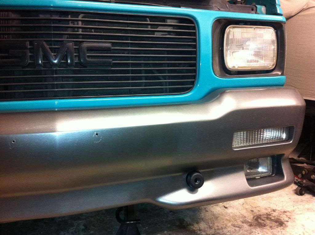

Looking at adding a tow hook to the front. Looking for idea's, I've got a pretty solid one thought out at the moment. I'd be using a bolt on mount next to the lower heat exchanger mount. It will require drilling a hole through the front bumper. I was planning on covering up with our required front plate in Texas.

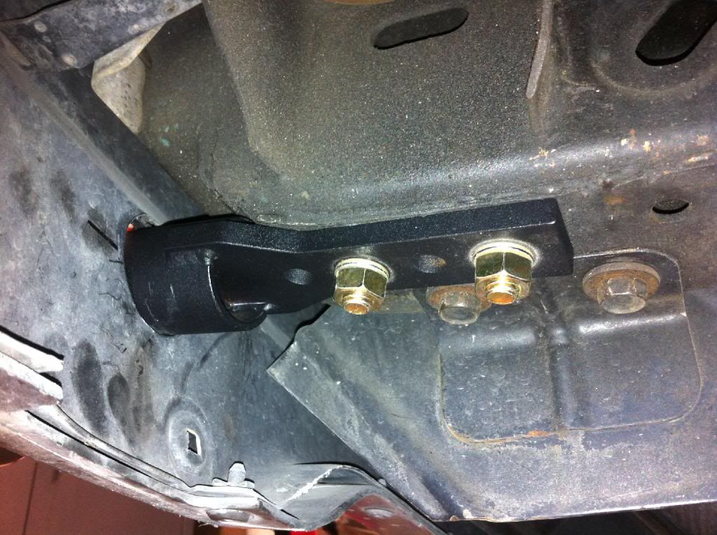

I will bolt it to the lower frame for the bumper supports. I ordered a receiver and screw in eyelet from renline. Planning on mounting it to the two holes next to the lower heat exchanger mount bolts. I'll update as I get it put on. This road racing stuff is fun!

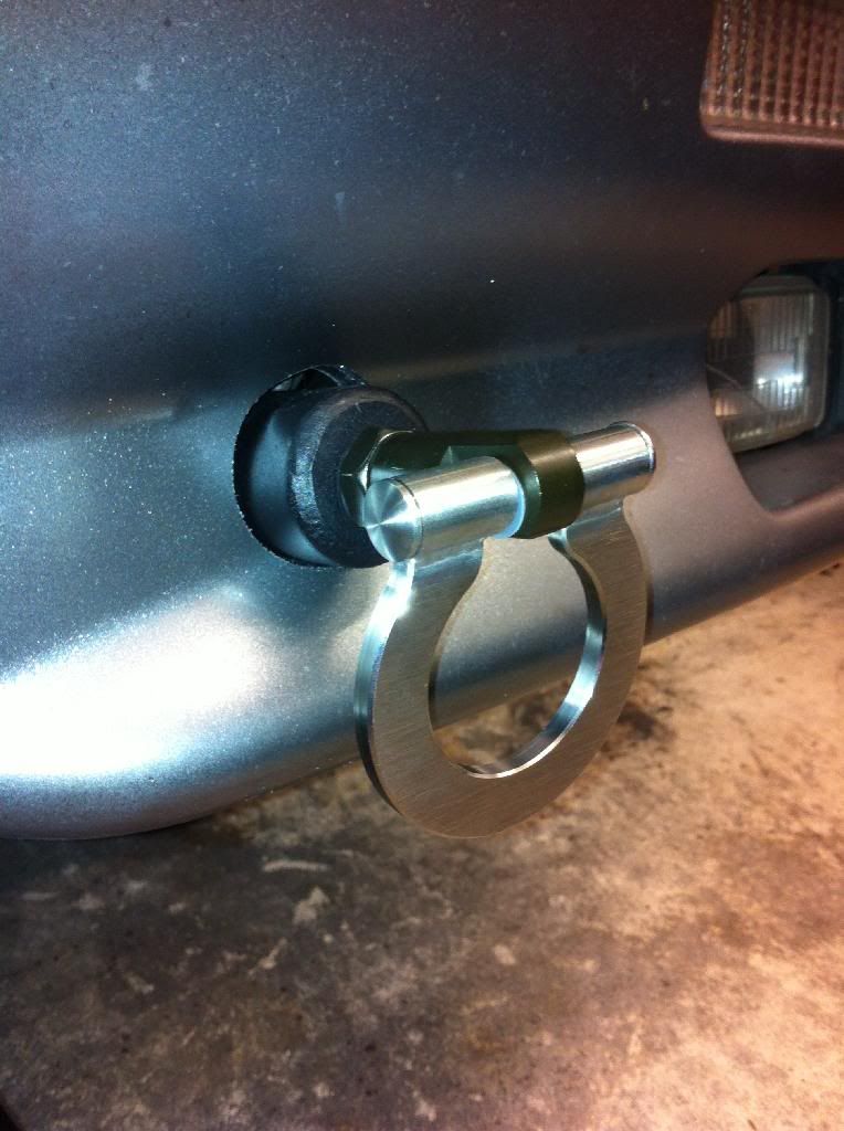

I finished up this project today, the rennline attachment is a nice piece. It wasn't until I got the part and looked though there catalog when I saw they offer front license plate attachment, also a gopro mount that attaches too the hook bracket. A perfect addition to having 3 uses with one mod. So May 17-18th I'll be recording from the front bumper
0966Sy
Code what?

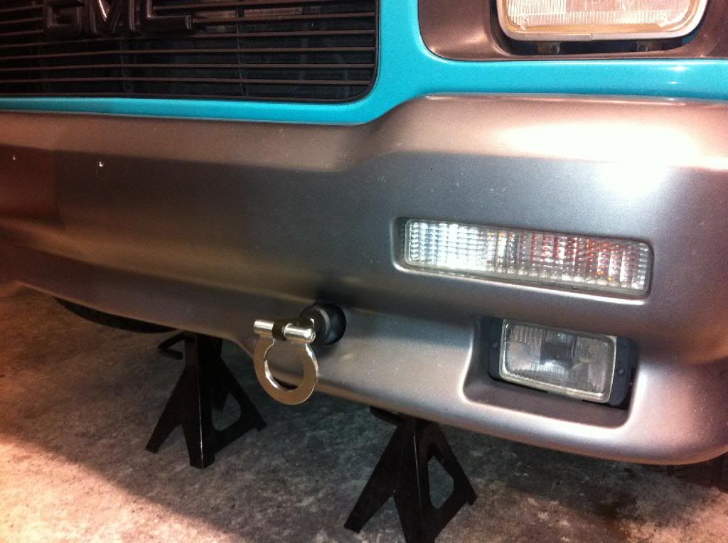

Update with plate mounted, also got the go-pro attachment for the tow hook. Not the greatest picture, just washed and no sunlight.

It's a shame to put a hole in the bumper cover, but with all the uses, and decent looks, I like it. It would be just about invisible on a black truck too.

I think ur fog light is cracked.
Thanks! It has been for several years now, seems like every time I've changed out the lens it gets cracked shortly after.
