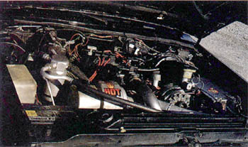

A guy here in Stillwater, OK has done one (this is in a 2wd S-10).... here are a few pics from our car show last year.... sorry, I don't have a name, but could probably round him up if needed.
I remember him saying it fell in pretty easily - I can't remember what tranny.
