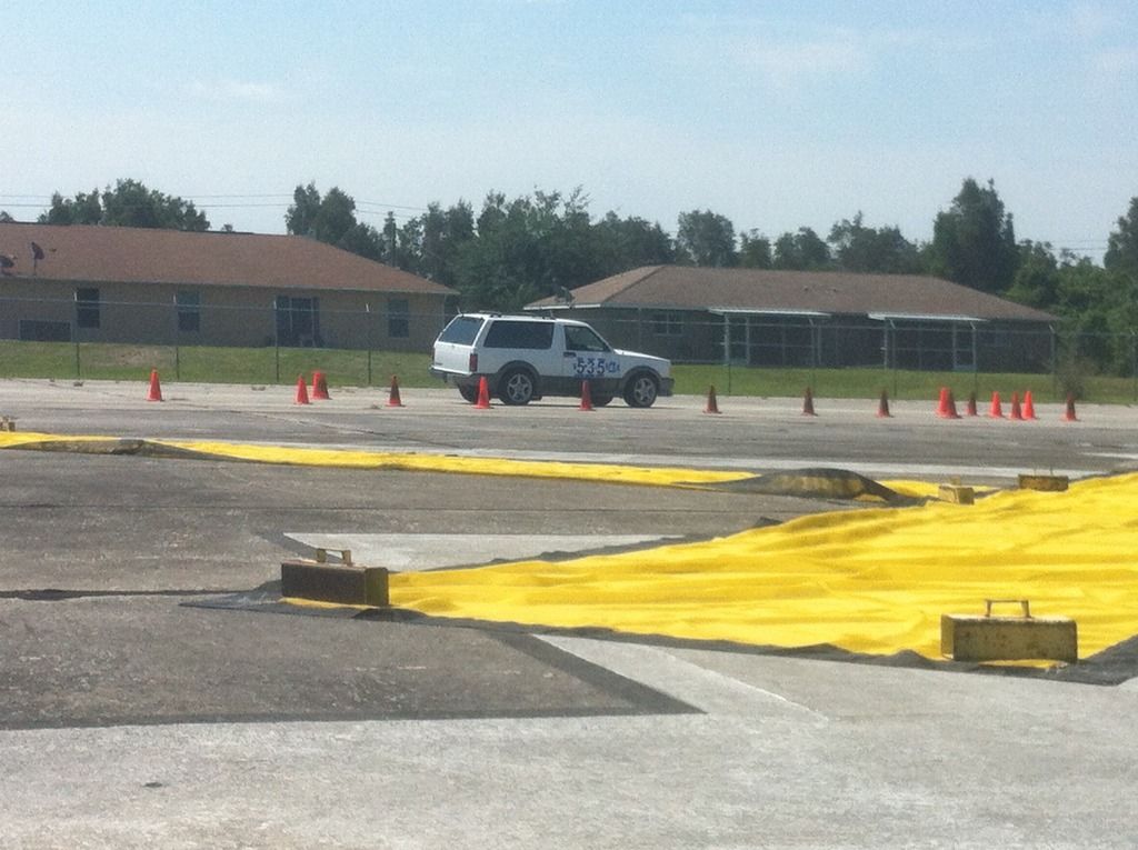

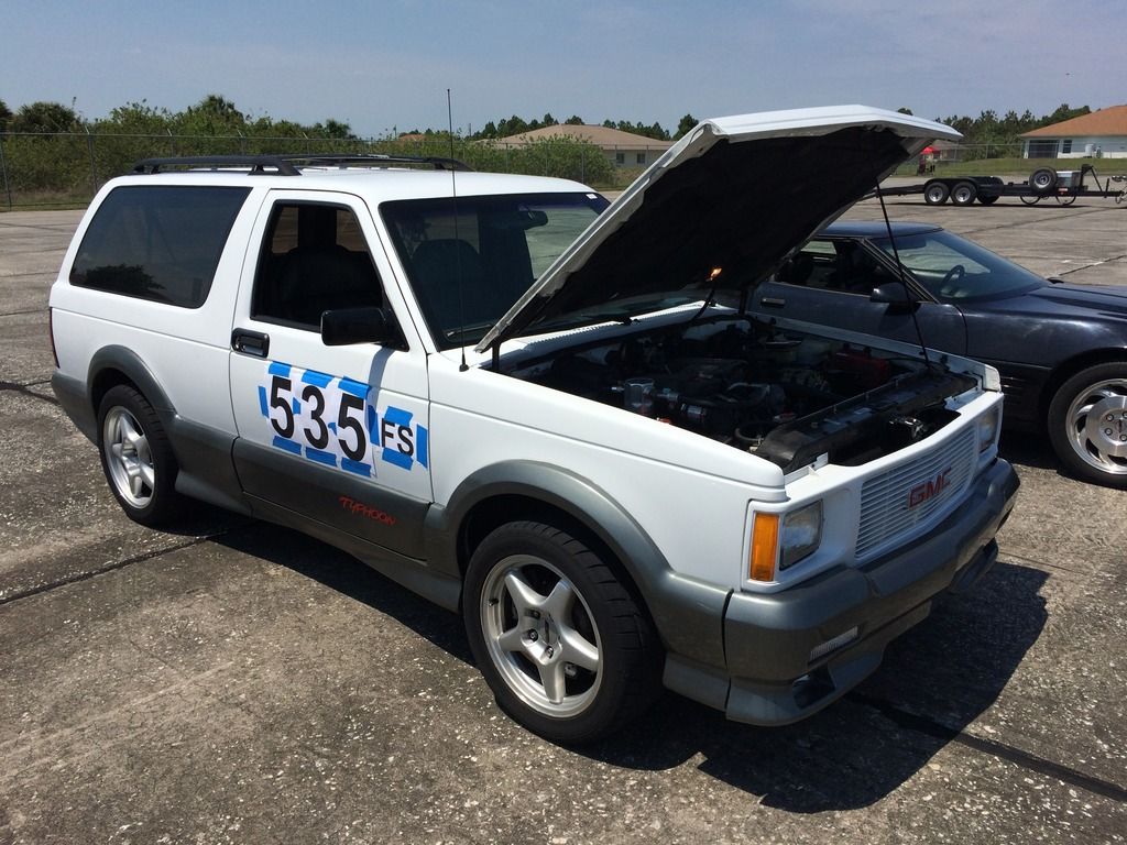

Got to try my hand at AutoX today. Holy crap was that fun. The novice school is awesome. The best learning experience was when the instructor drove the Ty. He pushed it hard and I'm really glad he did. It made me realize that this thing really can do this and actually be respectable.
I brought a buddy with me and he said the amount of chatter as ran was crazy. Everyone I meet commented on the Typhoon and were truly impressed as I went around the track. No one, including me expected it to do as well as it did.
I got better and better throughout the day and it is something I will definitely do again. I'll need to do a few things first. Probably weld up the stripped out sway bar screw hole on the drivers lower control arm, then get an adjustable proportioning valve for the brakes. Instructor could even tell rear wasn't braking as much as it should. Last, fix up some of the steering. Mines pretty sloppy; will convert to non-rag joint, and probably some new inner and outer tie rods. Last, one of my electric fans went out, I'll replace that too.
So hopefully I'll be pounding pavement again next month and run in the timed course.
