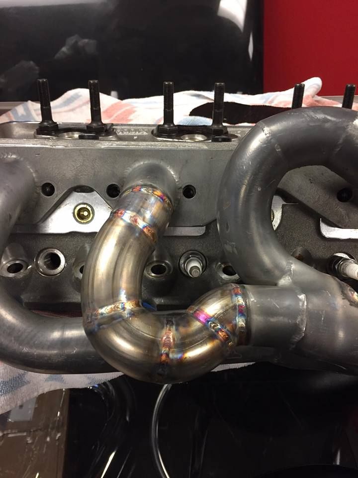

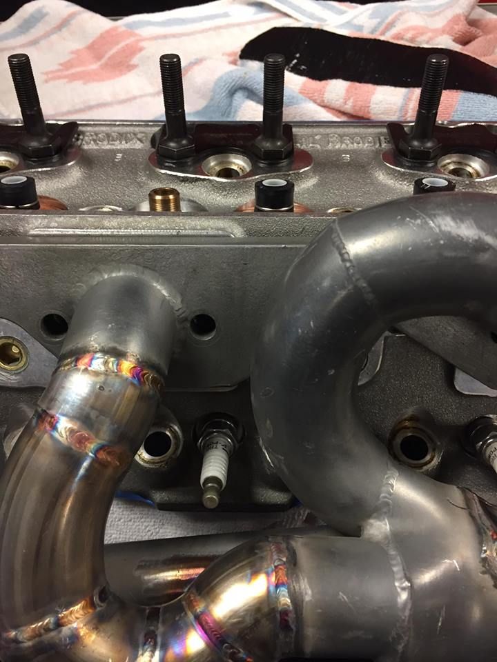

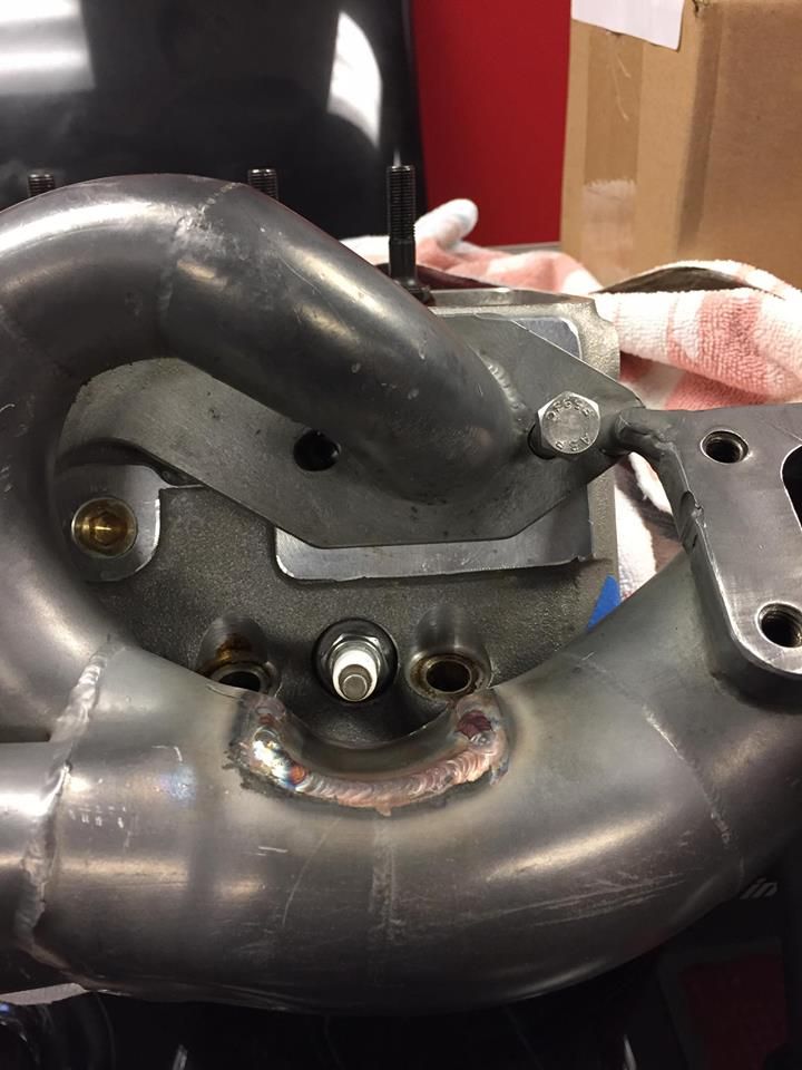

Painted the Lower intake Black for a new look on Ty 2.0. Should help make the Brodix heads POP.
Got the Pass Header modified by Sound Performance where I get all my Fabricating done. Had to Reposition #4 Primary tube to clear the Spark plug and also Notch the Collector. Work of Art Welds! My truck will be a Donor come Spring/Summer to build a sick set of Headers built by SP. The owner Larry used to own a Ty and told me he always wanted to build a Turbo setup.

The work on the headers looks great. You really are good at getting things just right.
