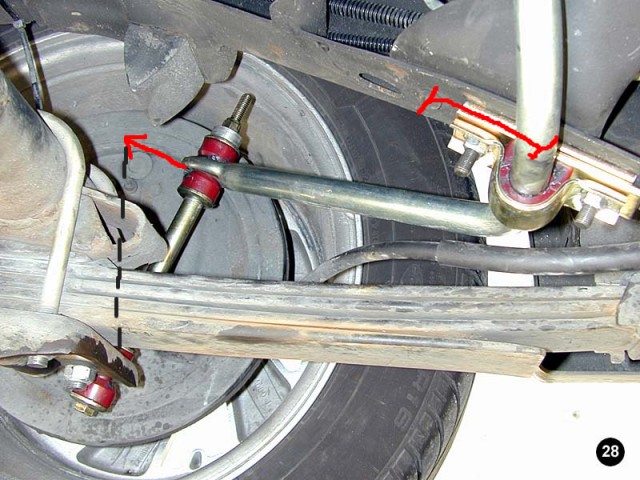

The individual who posted this pic, didnt even know it was contacting until we delved into the issue here. In fact he reported he hadnt experienced a contact problem prior to getting under there and taking pics. He also stated that his bar was of the new design.

That was not my ty, it was someones from NWSTP who installed it in accordance with the instructions you posted:
Daron posts this pic of the ADDCO bar on a Ty, showing how close it is to the leaf springs. Even moreso if they had been lowering springs...

Daron I think that I know why yours hits. Because the holes you used in the frame are NOT the same as I used. I mounted my bar so that the holes spacing over the rivets were ONE HOLE aft... I'm about 97.8% sure my bar mounts in a different location than the one pictured.
NJTy180 said:
well I can confirm the other 2.2% that Todd is correct. Not only was I on the same Addco GP as him, but my bar is also mounted in the same location as his. The backing plate which bolts to the frame has a hole in the center of it for the purpose of going around the rivet in the frame. One hole drilled above and one below.
Todd and Morgan say that their bars are mounted one hole over. Their mount straddles the rivet in the frame, putting the bar mount closer to the center of the arch, giving more clearance.

But Rick's bar is also mounted the same way as on the first truck Daron posted - not centered over the rivet. His endlinks seem to be angled too (indicating the bar is mounted too far away).
Rick's just barely seems to be hitting, as the mark seems to be quite small, even with lowered springs. I'd like to see how things would work out if he moved his bar mounts closer to the center of the arch, centered on that rivet. The link for the pic of the instructions doesn't work anymore, so I have no idea where the "right" place is to mount the bar, but centering it on the rivet like Todd and Morgan did seems to be right (more clearance, straighter endlinks).

Hmmm, very interesting. I thought I'd followed the instruction sheet faithfully, but could be wrong. There is, of course a rivet at the leading edge of the crossmember as well, so the center hole in my mounting bracket is also straddling a rivet. Not sure when I will find time to correct this, but will post pics when I do.
InvisiBill
I haven't seen the instruction sheet, or even any swaybars yet, so I can't help you with that. But just going by what I've read in this thread, it seems as though it would be "more right" if it were mounted further back on the truck, closer to the center of the arch. Looking at the bottom part of the first Ty's endlink compared to the bottoms of the U-bolts, it looks like it's a lot more angled that it appeared to me initially even.
Just doing some mental rearranging on the first pic... If you move the end of the swaybar as much as the distance between the current mount and the other rivet, it looks like that would make the endlink pretty much parallel with the U-bolt there. That would put the end of the bar about where that little circle is on the backing plate there. Drawing a line from there down to the bottom endlink joint seems to make it look pretty much vertical.
Like this...
Thanks for at least considering what I had to say. =) This thread didn't really produce much other than Person A swears by Brand X and has had a billion problems with Brand Y, while Person B swears by Brand Y and has had a billion problems with Brand X. It would be great if simply moving the bar mounts a tad would fix your contact problem, and maybe some others' problems too. Perhaps the instructions don't specify which rivet, or specify the wrong one? I personally think it'd be quite cool if we found out this was the cause of a huge chunk of the ADDCO problems, especially since it's such a simple fix.
turbodog
Based on Tydriver and NJTY's input, I'll give it a try. I would've thought that doing so would cause interference between the endlink and the axle tube. IIRC, they are pretty close on mine as it is. But, it won't hurt to unbolt it and slide it back to the next rivet. If it looks like it will improve the geometry, then I'll drill the holes.
canadian
sy in progress
well, the preliminary fit is done and it looks like it's going to work just fine. the only problem is going to be drilling the holes to mount the upper dogbone mount. the only place i could see it fit properly was inside the upper shock mount.
after having the addco and seeing all the other designs out there, i have to say that this is probably one of the better ones. no more flimsy end links as the dogbones on the end are much beefier and don't look like they're going to bend any time soon.

BTW, just to follow up, I DID try to relocate the sway bar mounts on the frame as sketched by invisibill. I found this put the ends of the swaybar DIRECTLY above the axle tube. No way to connect up the endlinks. I put it back where I had it (also straddling a rivet, BTW). I did shorten the endlinks, and this improved the overall fit and reduced the interference a little. Looking forward to Canadian's pics.
