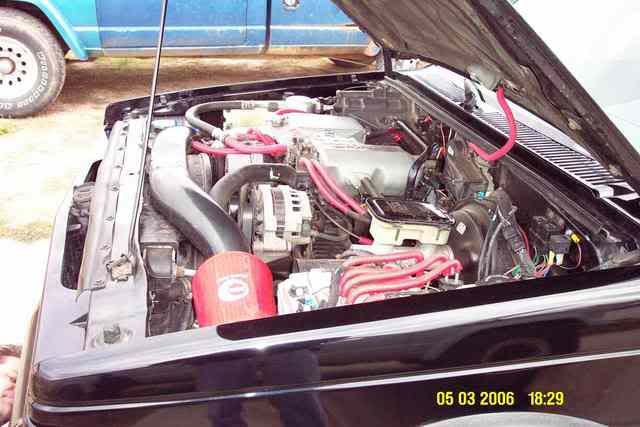

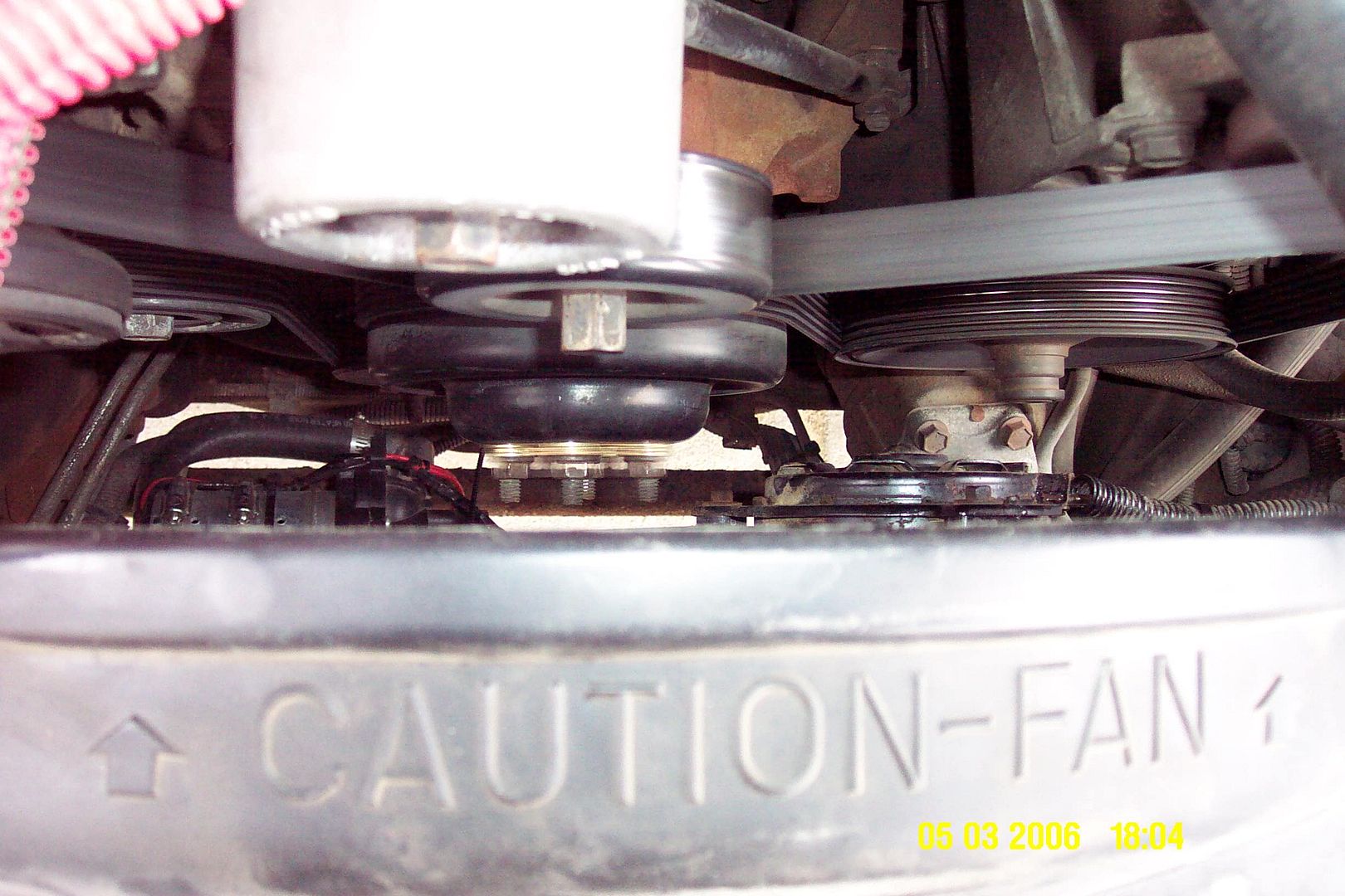

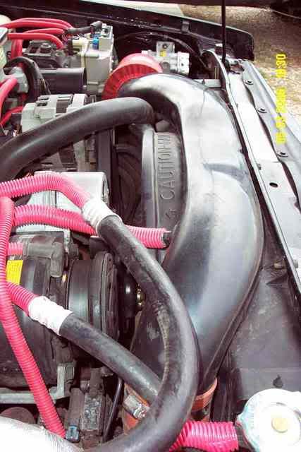

I just got done installing a 94 Lincoln 3.8 2 speed fan. It took some modification but I am still running the factory top radiator shroud and just had to trim a little bit off. It appears to be stock. I'll try to take some pics of it tomorrow. I just got done with it and did some test running tonight. I have it on the high setting and it dropped the temp 10 degrees within a minute. Only spent $20 for the fan at a junk yard plus $6 for the mount kit at Checker. It's like this one: http://i4.ebayimg.com/04/i/06/34/f7/b4_1.JPG or http://cgi.ebay.com/ebaymotors/Must...ewItemQQcategoryZ33600QQitemZ8056528164QQrdZ1
